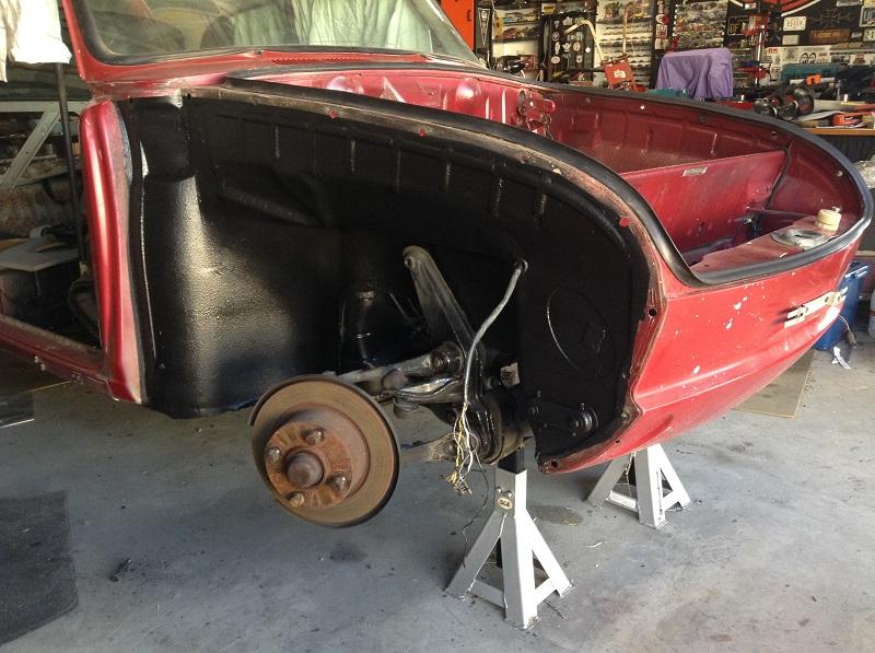

Unbolted the bumpers and fenders. Pretty stoked to find no rust in the inner guards! 8)

Post by MID WEST DUBBER » 22nd February 2018 - 10:37am
I stripped a few more parts off the notch including doors, bonnet, decklid, fuel tank etc.
with the fuel tank out it made it a lot easier to start disassembling the front end and brakes to make a start on cleaning everything up.
Front end disassembled gave me more room to clean back everything and I prepared the inner fender etc for paint.
A little more work painting some front end and brake stuff and it was almost ready to start renewing and putting the front end back together and back on wheels.

Also took the discs off, cleaned them up and painted them and had them machined. Also painted the backing plates and calipers.
Before..
After..

There were only one or two spots of rust in the body just around the base of the windscreen. Will be doing the finishing touches to this repair when I start paint prep down the track

I've never seen a notch, or any other type3 with so little rust.
Class car...
