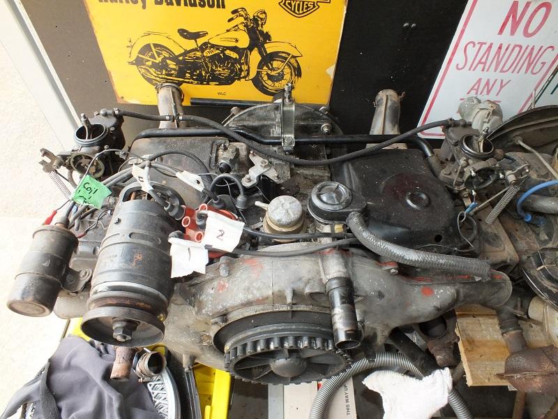

The engine needed a big tidy up, this is what I started with

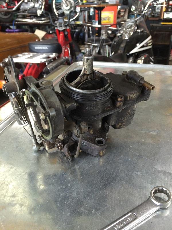

Post by MID WEST DUBBER » 6th May 2018 - 12:33pm

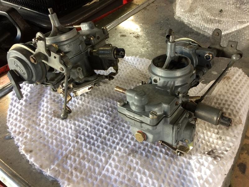

The carbs needed a good clean and rebuild. The accelerator pumps on both carbs had an extreme amount of wear where the connecting link mounts. So I welded the holes up carefully and then re-drilled the holes.
I think they came up alright

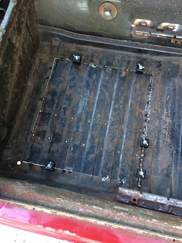

The seat rails on the right hand side were broken and twisted. Was lucky enough to get onto some replacements a little while ago. Also some floor sections that were sourced helped me to repair a rusty section of the floor on the drivers side.

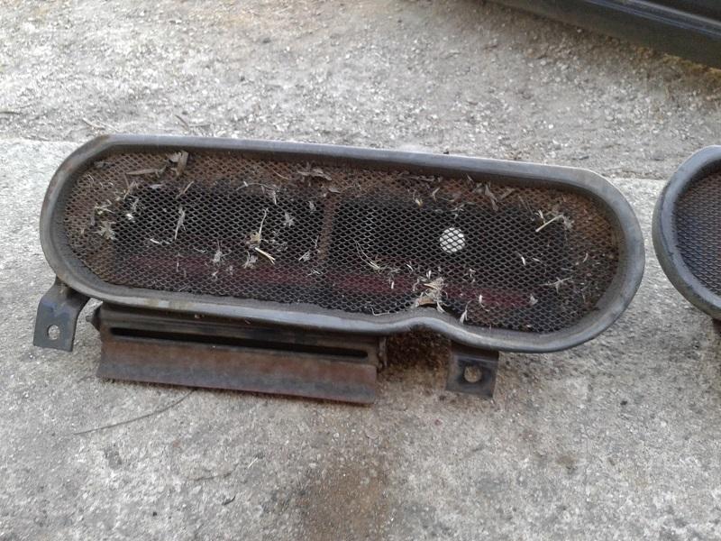

Post by MID WEST DUBBER » 23rd May 2018 - 11:58am

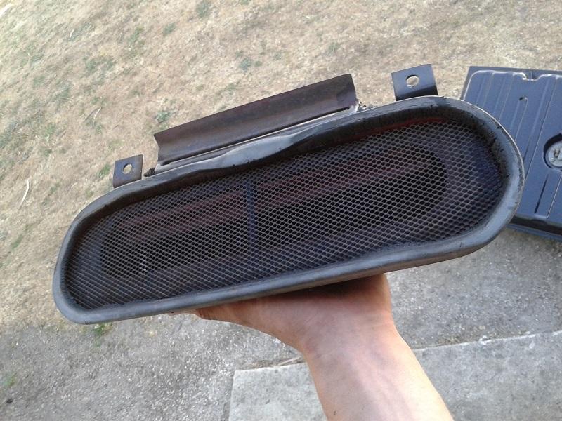

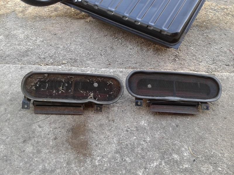

The fresh air control boxes under the dash were in need of some love. Cleaned them up, removed the old perished rubber, painted and installed the new rubber seals. I found these air boxes were a pain in the ass to remove and reinstall but got it done over a few beers.

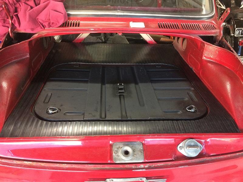

Post by MID WEST DUBBER » 3rd October 2018 - 1:28pm

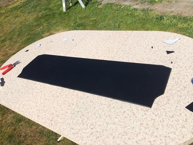

Engine is back in and have been sorting out a few jobs in the rear luggage compartment. Made a new rubber mat to lay around the hatch and gave the hatch a quick refurb.

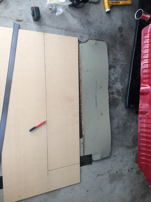

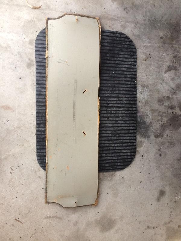

Realised the rear seat/ luggage compartment closing panel was missing. So i pulled the one out of my '70 Notch and made up a new one to cover with black vinyl.
