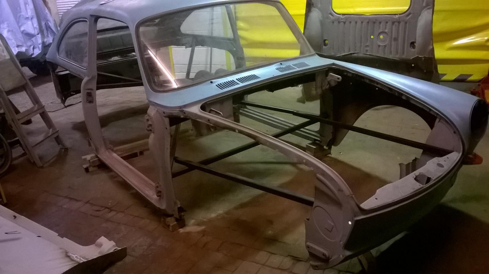

Post by fastty » 27th December 2017 - 10:44pm
cheers broady-6, :thumbsup:

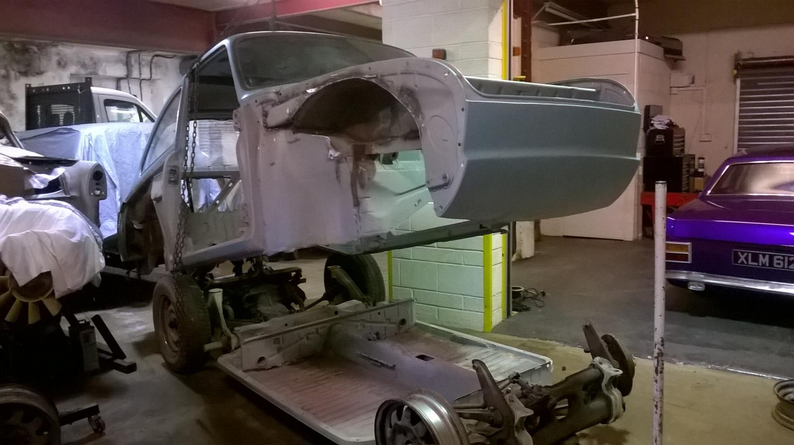

got alot done today, body is now off the chassis.
wanted to mock the shell up at ride height with the wheels on to get an idea of how its going to look.
then it was time to brace up the inside of the shell ready for cutting.
to make way for the new chassis and to be able to put a v8 up front the bulkhead and the inner wings are being cut out along with all the inner structure in the rear.
im afaid theres not much left of the shell. :(

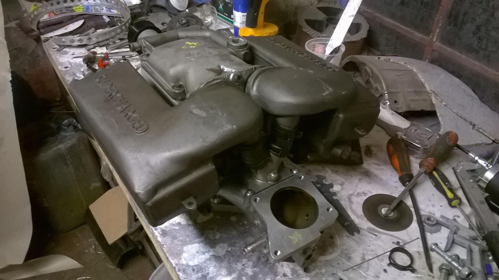

Post by fastty » 4th January 2018 - 10:57pm
few parts landed this week, mainly the xjr supercharger setup that im going to fit to a 3.9 rover v8.
going to weld up the chassis jig tomorrow so should be able to start building soon.

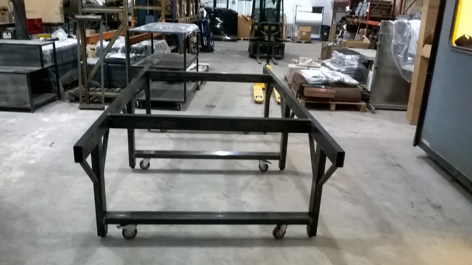

Post by fastty » 6th January 2018 - 10:04pm
before building the fassty i needed a jig to build it on and after many sleepless nights i came up with this.
it can be moved around on the castors and leveled up on the adjustable feet for building, result .
with the jig done i can now get on with building the chassis this week.

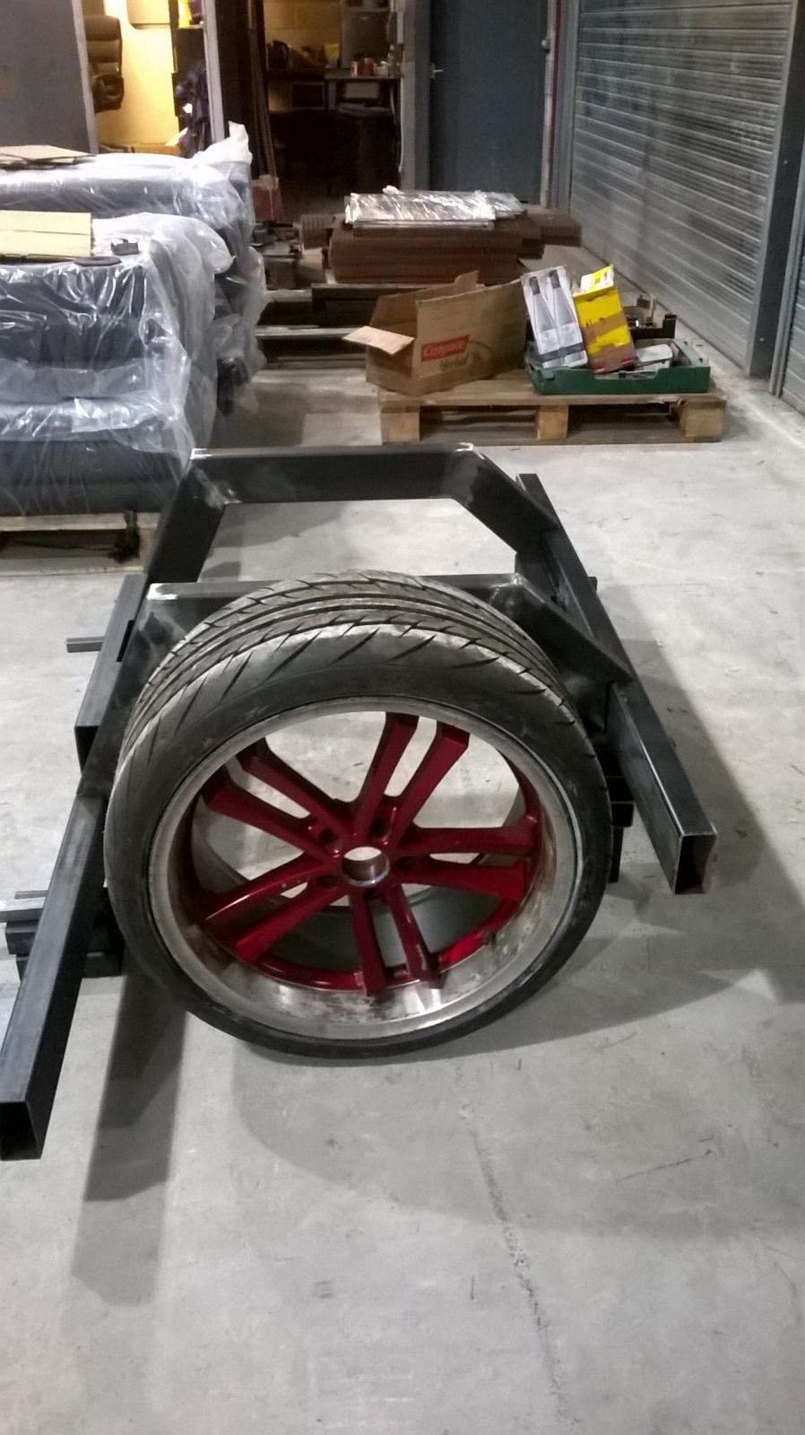

Post by fastty » 9th January 2018 - 11:29pm

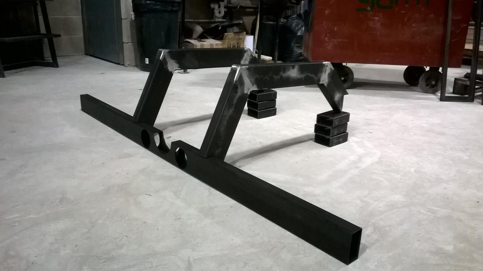

finally got to do a bit on the chassis. started with the rear kick ups, got them welded and then set them at ride height with a wheel just to make sure its as i wanted it.

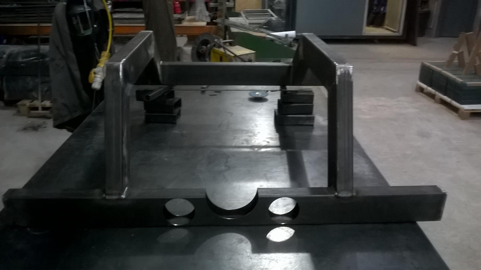

Post by fastty » 12th January 2018 - 8:50pm
bit done today, got the rear section of the chassis all welded up.

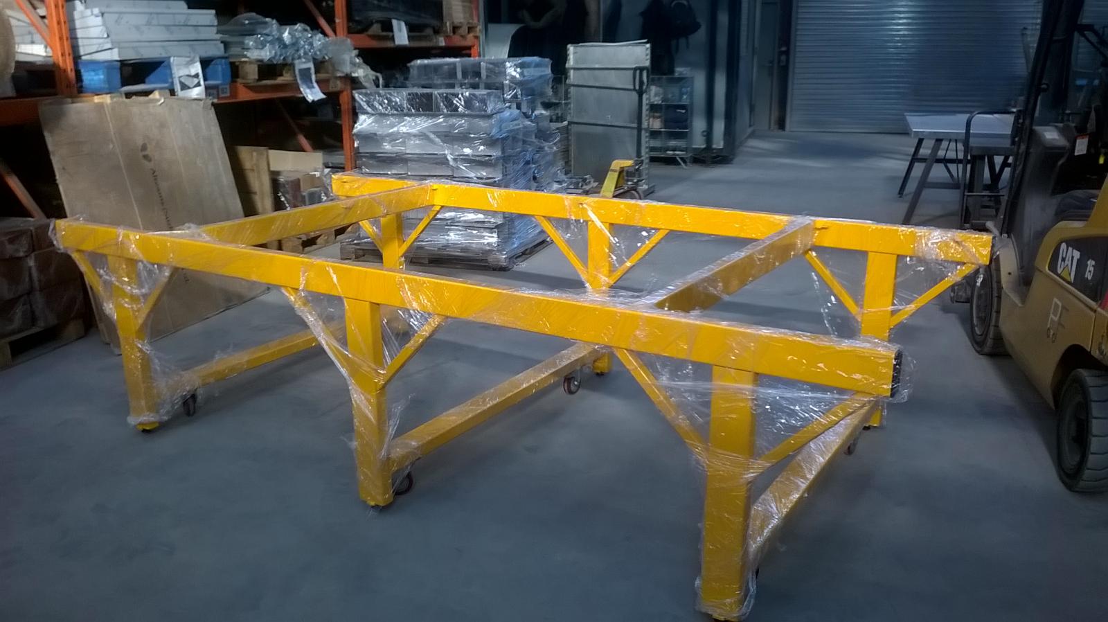

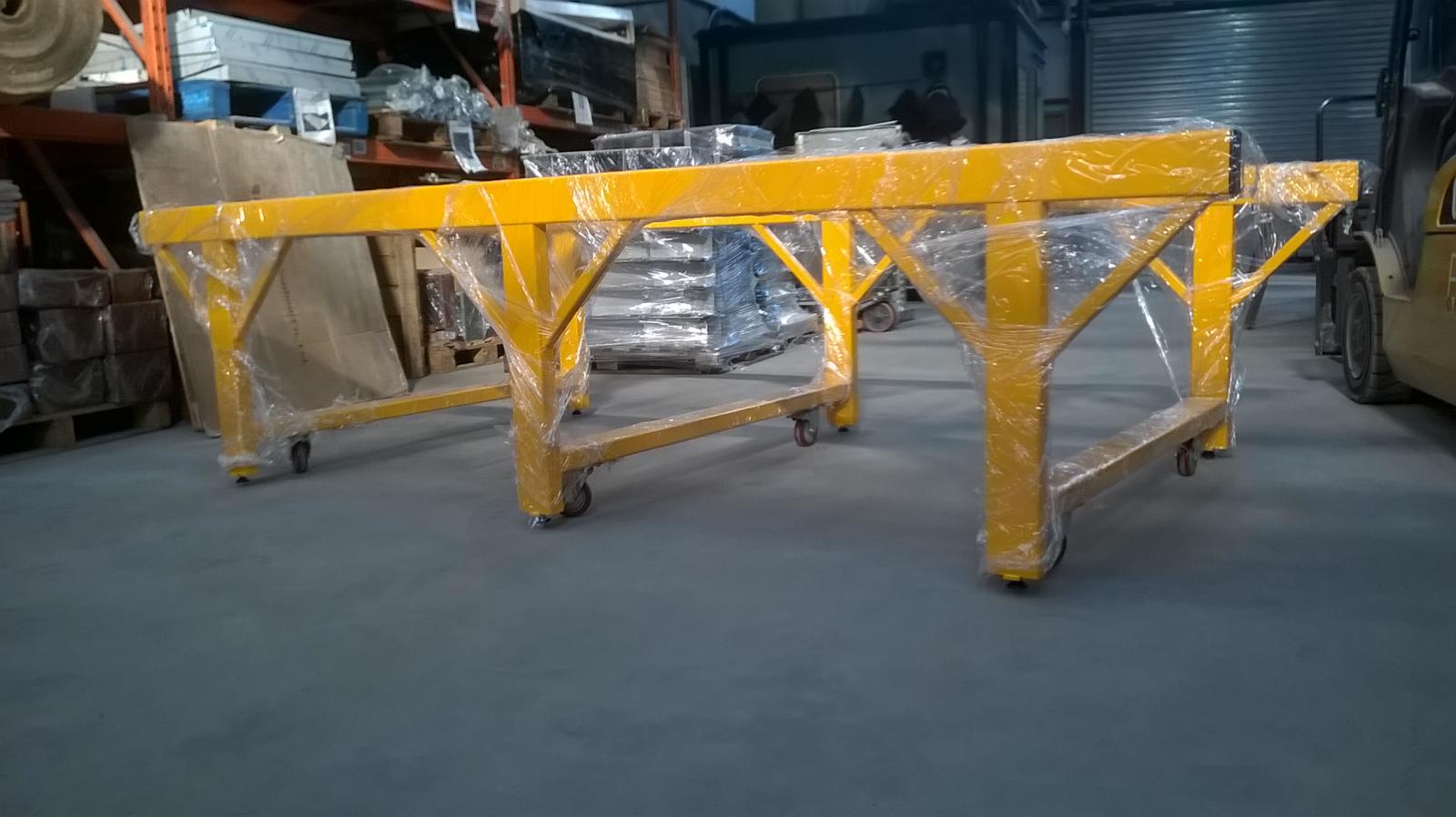

Post by fastty » 2nd February 2018 - 6:10pm
the chassis jig turned up today from the powder coaters, :D
it really looks the part and im that impressed with it im going to have them lasor cut so if any one is interested just give me a shout for more information.

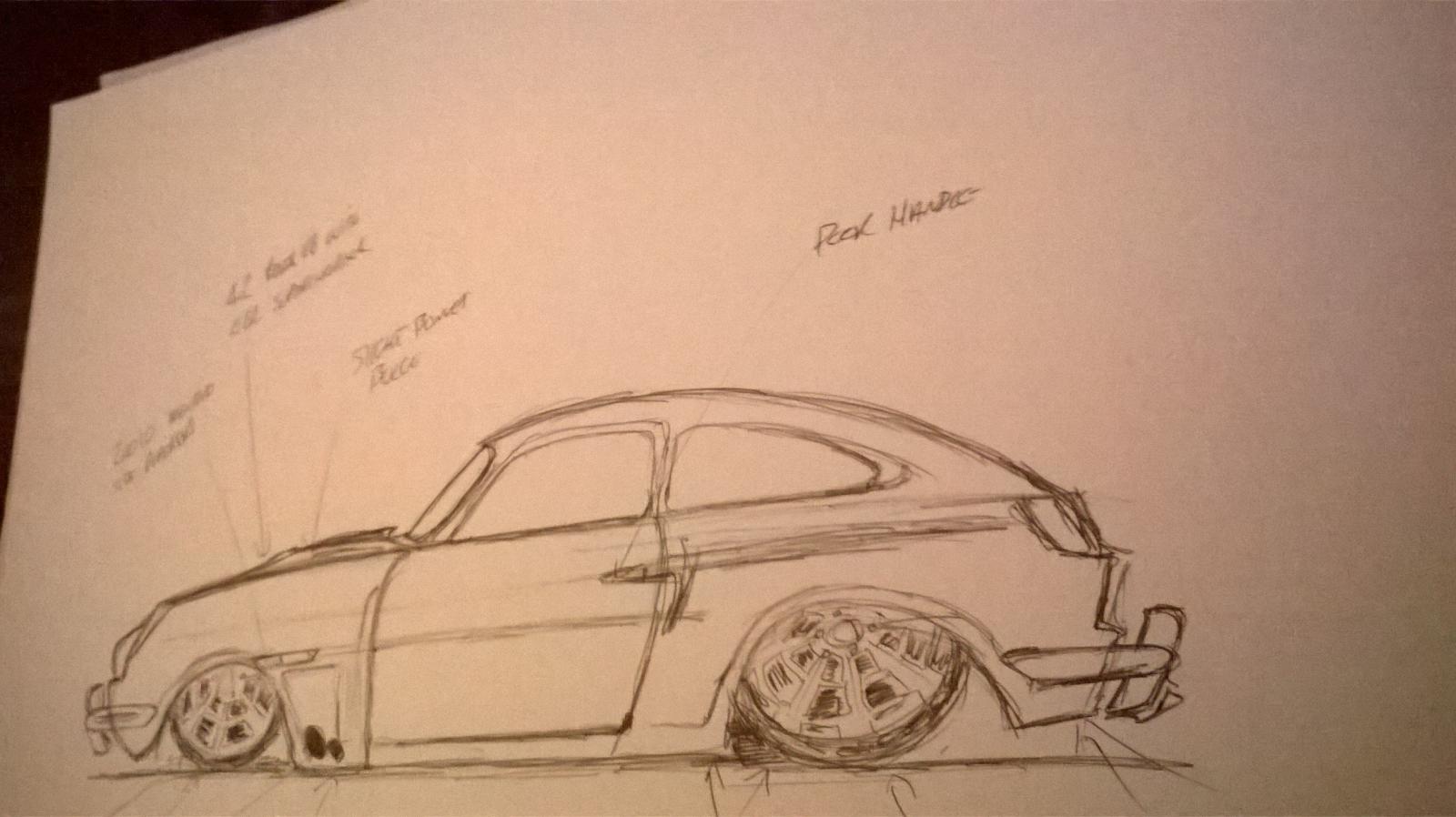

Post by fastty » 19th February 2018 - 8:51pm
cheers guy,s
i am finally making a little progress, got the body sat on the chassis jig.
still got to fix it to the jig but i cant do that untill i have stretched the front wings about 6" so i can sort the front chassis. with the wings being stretched i have to move the front wheels forward 6" aswell so it,s all going to take a bit of thinking about.
the reason im stretching the front wings is i want to give the fassty the pro mod look, did this quick sketch to give you an idea of were im going with this project.
more later in the week

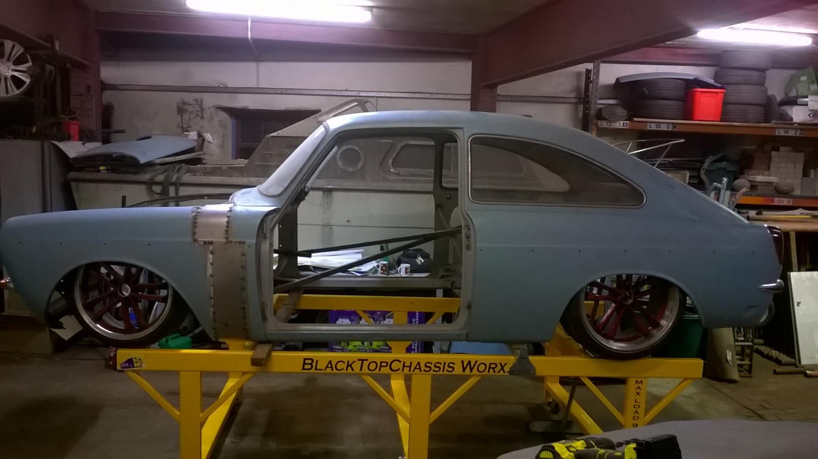

Post by fastty » 20th February 2018 - 11:47pm

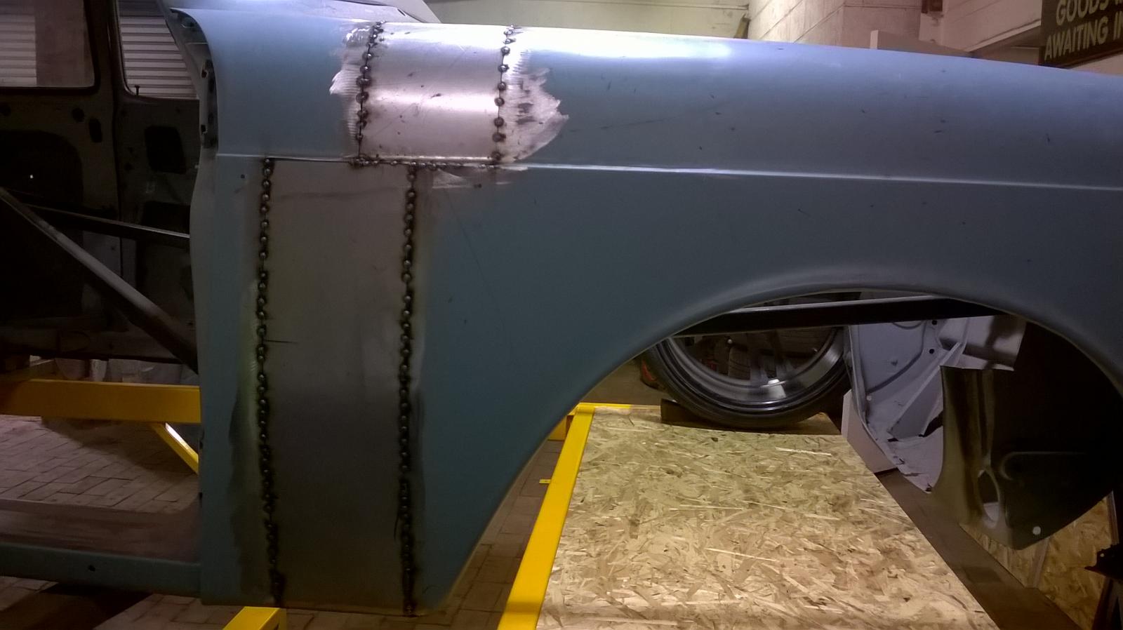

once i had worked out how i was going to stretch the front wing i just cut it, made a filler panel and tacked it all up.
with the wheels mocked up in place it gives a good idea to how it,s going to look.
really like how it looks, just need to get on with the rest of it.

Post by fastty » 24th February 2018 - 11:03pm
cheers,

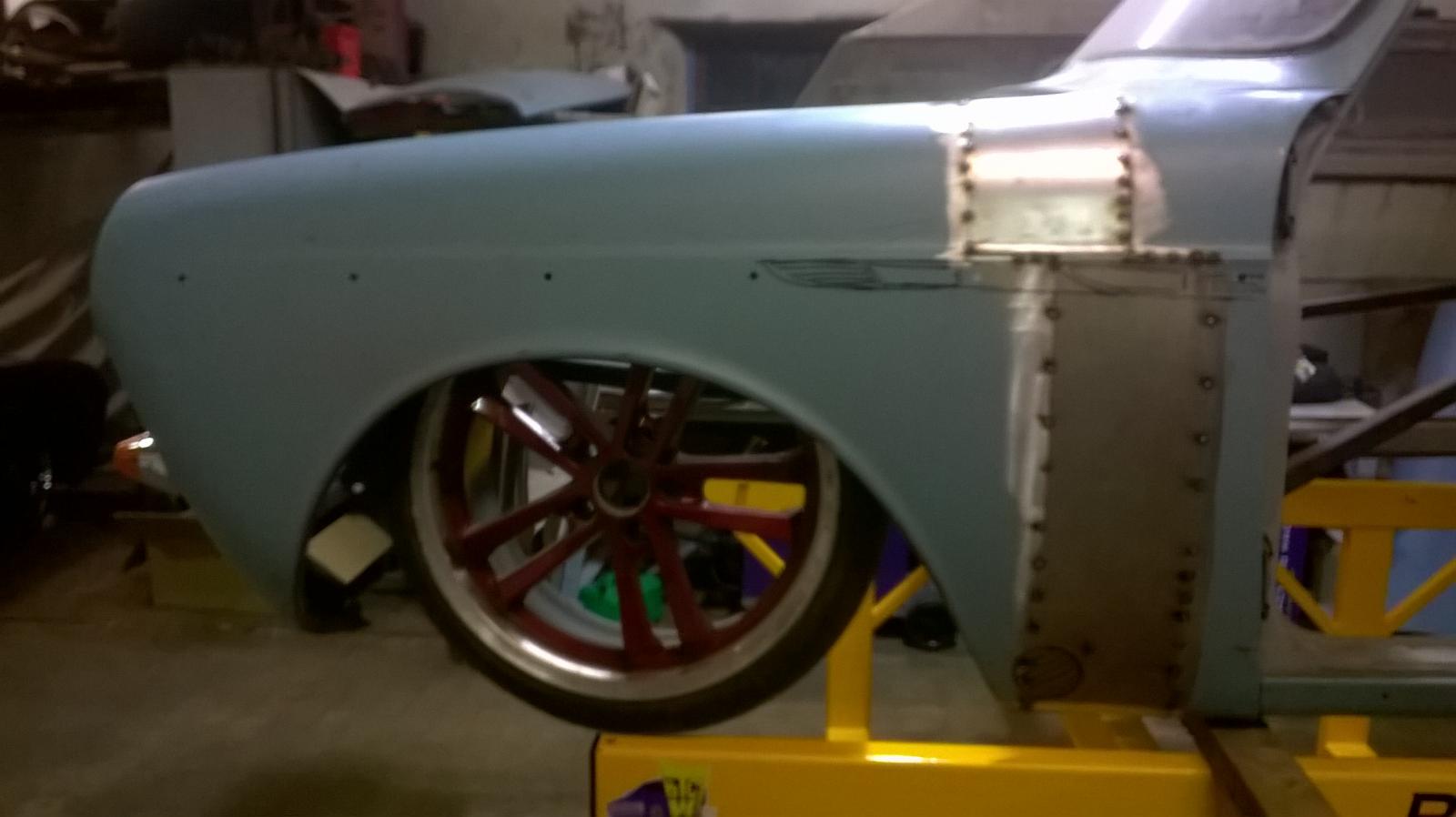

got the other front wing tacked up today.
also got the first front wing sanded up and back on the car along with the door.
this is all i can do to the body , i need to get the chassis set up at ride height on the jig so that is this weeks job.
