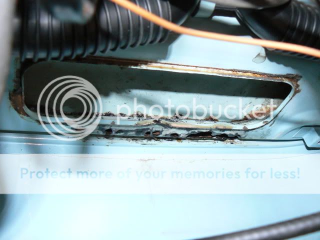

Hi Dave,
Thanks for that response, did you repair the deflector plate from above then, or did you manage to remove it. Mine had rusted through like this:
so I liberally covered it with kurust and stuck a patch on the underneath to stop the leak - that, and clearing the drain hose at least stopped the water coming in the car. However, you can see from the picture that the front of the airbox was starting to rust from the inside, and with the difficult access, I must have missed some bits with the kurust. Should also have covered it with some other paint too I suppose. Anyway, it appears that some water gets into the car now during heavy rain and while fixing the washers for the MoT that's due soon, I noticed that the rust had broken through the airbox.
So, what I think I'll do is chop the top of the airbox off carefully, and make a lid from it as I hope it can be repaired enough to do so. I'll use some strip to cover the gap and provide a means of locating, fixing and sealing it. It's a pain as my inner wings, spare wheel well and everything else under the bonnet are mint, but hopefully I can make it look like it's supposed to be there. Once I have access, I can then properly repair the deflector plate, and the removable top would enable regular unblocking and maintenance of it.
