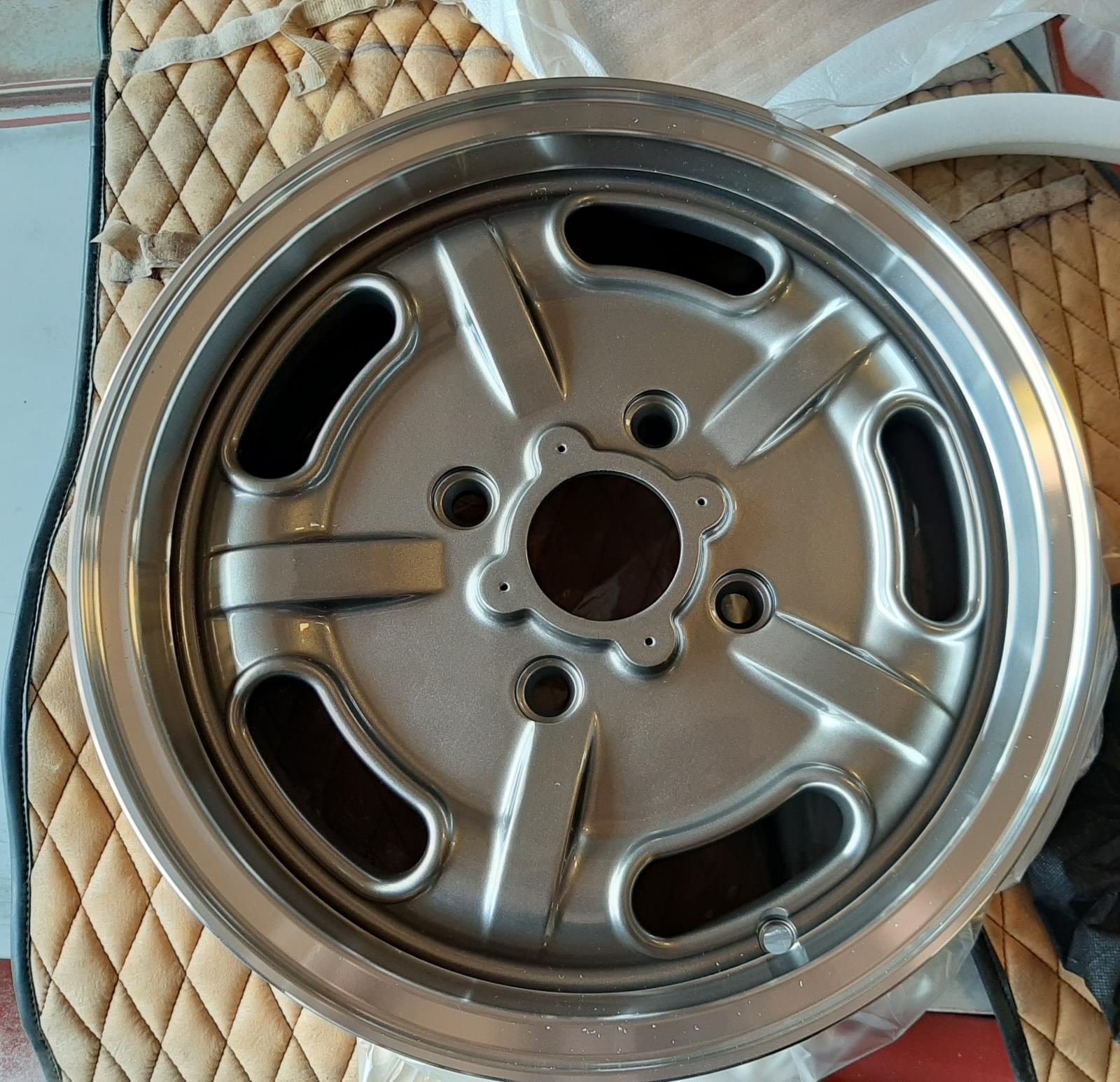

4 lug Speedmasters, very nice.
Re: Casa de Fye's autos...
Yes, 5.5 with 4.75 backspacing...23x7x15 tires on the rear, probably 175/60r15 on the front.
