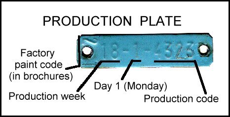

From August 1969, VW fixed a production plate which holds the information you need for the next step.
| The Air-cooled Production Plate |
This plate is found on Beetles,
Type 3s and Type 4s on the front panel near the chassis
plate, but painted in the body colour. It gives the
production date as the week of the calendar year,
and the weekday. Thus this car was made on Monday, Week 18 (a 1971 calendar lets you work out the actual date). Its factory colour code is 21, which is Marina blue (shown in brochures). |
For Type 2s, the details may be found on the plate behind the left-hand front seat. Look for a sequence like the one above. Mine (1974-model) is in the bottom left-hand corner of the plate; week 43, day 5 (Friday). I think some numbers on the plate are the factory extras fitted. The factory paint code figures for this should be 07 (Brilliant Orange) and 06 (Pastel white) but I see no certain indication of that.
| 42 052 165 922751 A41 072 191 43 5 7683 EN 2340 11 |
Week 43 for a 1974-model means week beginning 22nd October 1973, and a calendar reveals the build date as Friday 26th October 1973.
Latest :- VW has just (3/98) confirmed 26th Oct. 1973 as the date of production of the Camper (e-mailed to them at the above address)
